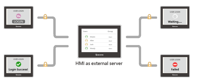

The other type uses a remote HMI. As illustrated in the figure below, the middle HMI may be used as the external server which stores all user account data. When a user logs in from one of the other HMIs, the HMI connects to the “HMI server” to process user login. The advantage for remote HMI is that no additional hardware / software but HMI itself is needed. Furthermore, similar to LDAP, HMI-HMI communication may also be safely protected by encryption.
* Using an HMI as the external server.
These solutions are just what Gary needs. Where conventional user management requires user account management on each HMI, now Gary simply needs to update user account data in the external server, and the changes are effectively reflected on all devices at once. For people like Gary, centralized user account management will prove to be time-saving and make factory management a lot more efficient than it used to be.
