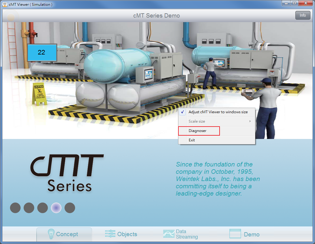

How to open Diagnoser:
In off-line/on-line simulation, this feature can be opened from the right-click menu.

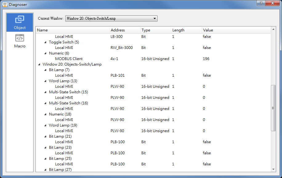

In the Diagnoser interface, the objects used in the current window and their operating addresses are shown in a table.
Changing register values in Diagnoser is possible by selecting a window number in [Current Window] drop-down list.

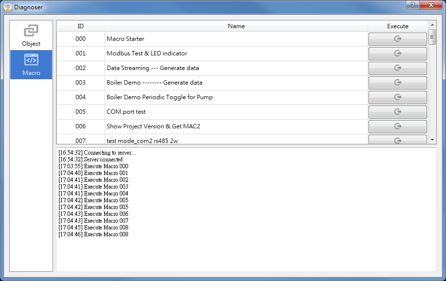

Diagnoser also allows triggering macro and provides results viewer.
Please note that Diagnoser will not show objects without operating addresses, for example, Function Keys.
