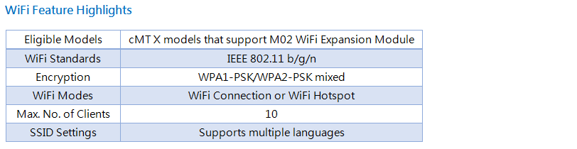

WiFi-enabled devices, having few installation and wiring restrictions, are ideal for mobile application, remote monitoring and device maintenance. Normally, these devices connect to networks via wireless Access Point (AP). For cMT X HMI with M02 WiFi module, however, it can not only connect to wireless AP but also switch to WiFi hotspot mode and function as an AP itself.

Enabling WiFi hotspot is as simple as toggling settings on a smartphone. All you need to do is to set the SSID and password from a browser or on the HMI, and hotspot will be ready.
