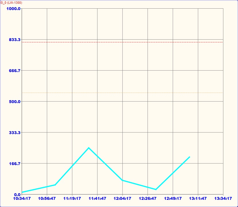

Energy Demand Display object graphs the result from Energy Demand Settings object at HMI runtime. Energy Demand Display clearly visualizes the changing of energy demand, and is highly customizable. You can customize the grids, texts, and lines to make the display very suitable for your application.
