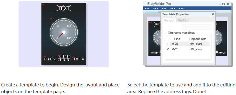

In response to this challenge, Weintek introduces a new feature in EasyBuilder Pro – Template. Similar to the idea of PowerPoint master slides, now developers can first define specific window pages as templates and replicate them in various pages within the HMI project. This feature helps developers expedite HMI program development significantly, leading to substantial time savings.

- Development: Developers can rapidly replicate designs from a template, boosting efficiency in the development stage.
- Update: Templates reduce the likelihood of manual errors when managing a large number of objects.
- Maintenance: When changes are made to a template, they will be applied automatically to all objects associated with the template, streamlining the maintenance process.
