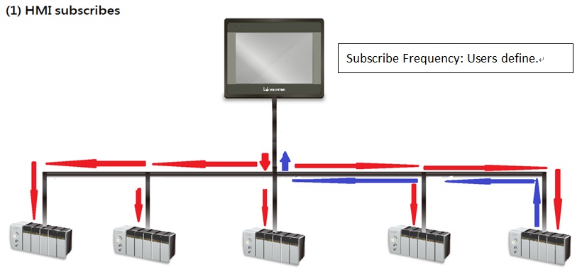

With the COV feature, Weintek HMI support the BACnet devices as active server. Therefore data transmission will only happen when: 1) HMI subscribes the command to the devices or 2) The devices renew the data, it will significantly reduce the communication flow.

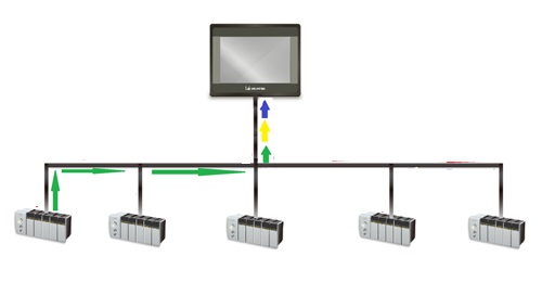

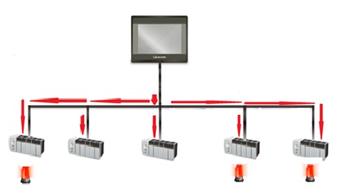

1. The HMI requests the data from devices (red line). Only three devices having data changed.

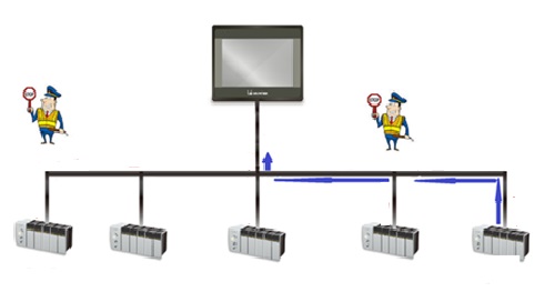

2. The blue line device will send the data back to HMI first.

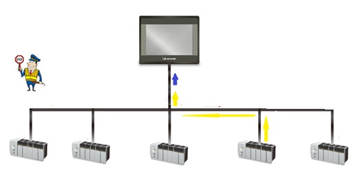

3. After the first device send the data, the second device will send the data back (yellow line).
4. The last device send the data back (green line)
