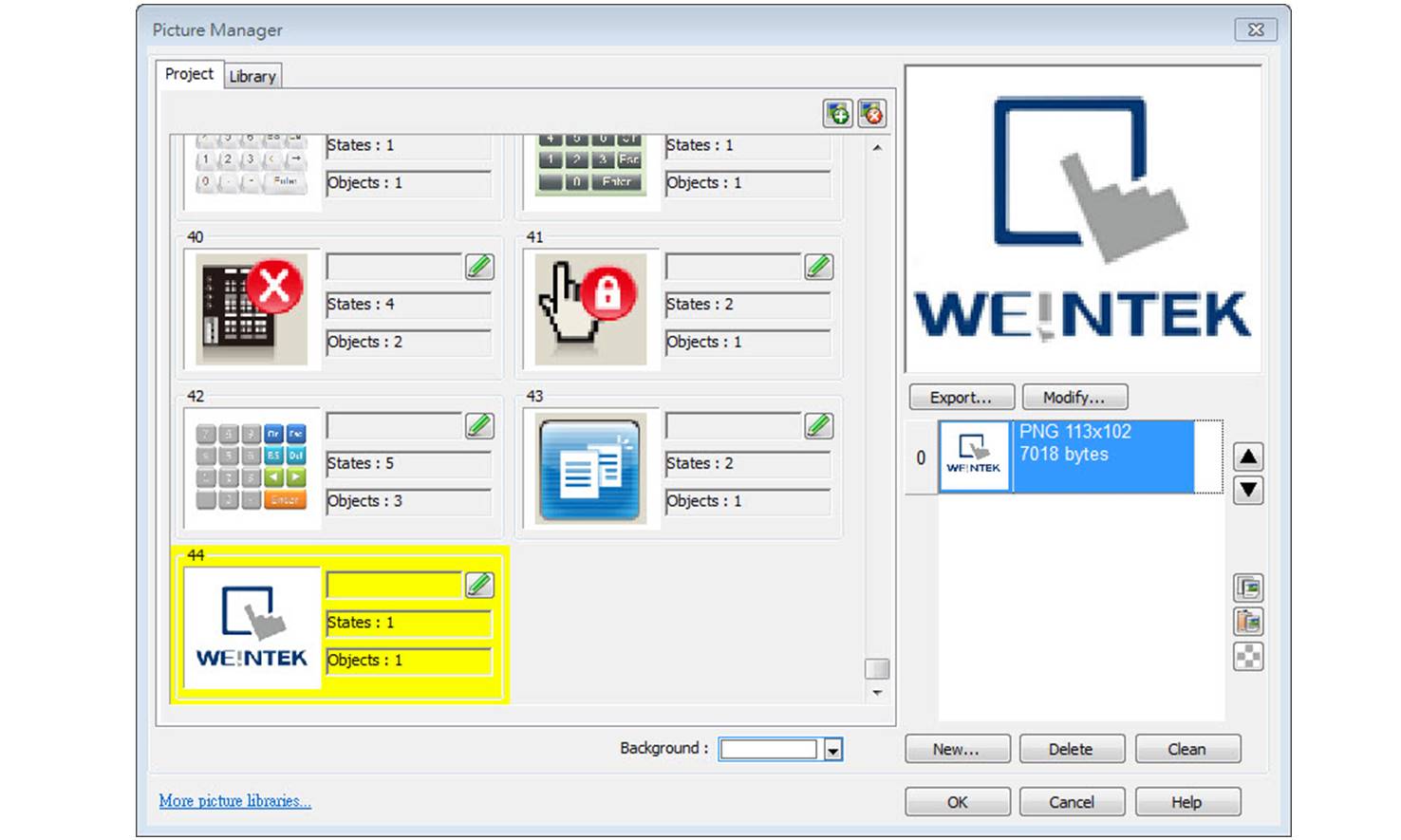

But now all you need to do is right click the mouse and choose [Copy image].
Then open the Picture Library, click the [paste] button on the right.
Then the picture will be added into the Picture Library without extra steps.
You can also directly copy the picture in the document, such as PDF and MS word. Or using screen capture tool for the screenshot you need.
