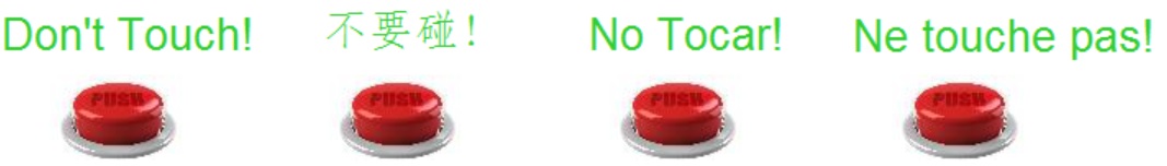

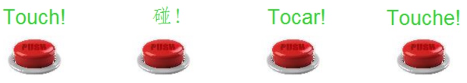

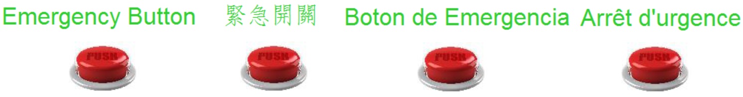

Example:
If you are a System Integrator, who needs to design project for different country’s users, but you’re not familiar with their language.
The reseller from that country can easily export the String Table by Import/Export function then using Notepad/Wordpad/Excel to edit the .csv file and correct the translation.
After correction, the reseller only needs to import the corrected file into HMI, without asking for the EasyBuilderPro project from SI and downloading the project into HMI again.
If the end user wants to use his own description, he doesn’t need to learn how to use EasyBuilderPro modifying the project first. He can easily change the String Table by exporting/importing .csv file.
