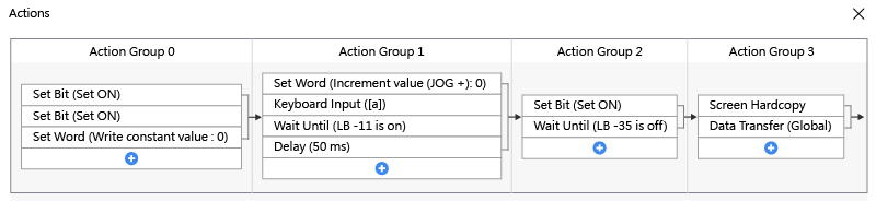

Action | Users can combine a variety of actions, such as Set Bit, Set Word, Execute Macro, Change Window, Screen Hardcopy, Wait Until, Data Transfer…etc. As shown in the following screenshot, actions within the same Action Group are executed at the same time. When all the actions within the same group are completed, the actions in the next group are then executed. ![]() |
