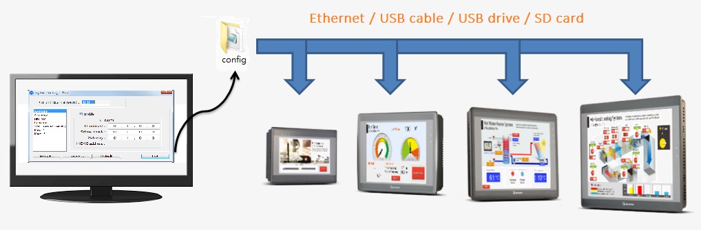

EasySystemSetting editing tool allows pre-configuring the HMI system settings on PC. The settings can be exported as a settings file, which can update the system settings on HMI, via Ethernet, USB cable, USB drive, or SD card.
The configurable settings include Network (uses DHCP or static IP), Security (stores all passwords for accessing HMI), History (deletes historical file), and more (includes VNC server, HMI name, HMI backlight brightness, or screen orientation…etc.)

When a large number of HMI units require the same system configuration or modification, EasySystemSetting editing tool can effectively finish the job by exporting a system settings file.
